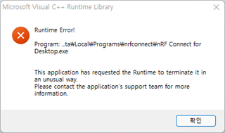

    Unfortunately, after I connected nRF52833 DK, these apps no longer detect PPK2 and dongle, even after disconnect 52833 DK, and for a few minutes after disconnecting DK, suddenly apps detect PPK2 and dongle properly again.
    And in this status, if I connect 52833 DK again, the following error popup appears.
