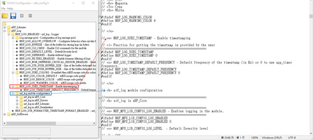

Hello All,
The problem is as stated in the title, my SDK version is v17.1.0.
For example => how to remove nRF_ANT or add it
Kai
  • You will need to open the sdk_config.h file in a text editor and manually remove the defines in question, I am not familiar with the syntax on how you actually can do this, it should hopefully be somewhat self explainatory when you open the file in a text editor. You can for instance find <e><q><o></e>... "tags" between the defines that configure the layout shown in the cmsis configurator. That said, I am not sure why you want to do this, they are just defines, and not used as long as the source files that use them are included in the project.
