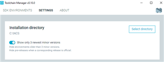

after installation I navigate from NRF connect desktop app -> Toolchain Manager
V1.71 is installed in D:\Nordic_App\Nordic_SDK\nCS directory

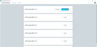

Problem 1:
I didn't get option of opening SDK in SES, it showed open in VScode, SES version installed is SEGGER Embedded Studio for ARM Release 5.66  Build 2021110300.48263 Windows x64
why it didn't show option of open project in SES? SES is already installed

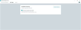

I cant change path I want to have folder directory in this way only D:\Nordic_App\Nordic_SDK\nCS
Thank you,
    I've installed nRF connect for Desktop & nRF Command Line Tool,
    Please find screenshot for version,

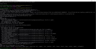

    the solution which was mentioned in that was to run 2 commands in git bash
    git config --global http.sslbackend schannel
    ncsmgr init-ncs
    as attached in git bash logs 1st comment which was printed was
    "NCS repositories are not yet cloned here. To do so run the following command:
    ncsmgr init-ncs"
    I've attached logs on executing the above 2 commands
    ncsmgr init-ncs
    LNTIES+40016482@MUTSL02323 MINGW64 /d/Nordic_App/Nordic_SDK/nCS/v1.7.1
    $ git config --global http.sslbackend schannel
    $ ncsmgr init-ncs
    Checking out NCS v1.7.1 ...=== Initializing in D:\Nordic_App\Nordic_SDK\nCS\v1.7.1
    --- Cloning manifest repository from https://github.com/nrfconnect/sdk-nrf, rev. v1.7.1
    Cloning into 'D:\Nordic_App\Nordic_SDK\nCS\v1.7.1\.west\manifest-tmp'...
    fatal: unable to access 'https://github.com/nrfconnect/sdk-nrf/': schannel: next InitializeSecurityContext failed: SEC_E_UNTRUSTED_ROOT (0x80090325) - The certificate chain was issued by an authority that is not trusted.
    FATAL ERROR: command exited with status 128: git clone --branch v1.7.1 https://github.com/nrfconnect/sdk-nrf 'D:\Nordic_App\Nordic_SDK\nCS\v1.7.1\.west\manifest-tmp'

  • Thank you for the answere.
    I just had fixed the problem: the problem was the network. After I changed the Network from my Computer, was there no Proxy anymore and the automatic installation was working.
    The installation of the connect sdk gives the user not mutch feedback, so the issue wasn´t clear for me. But now it works :)
