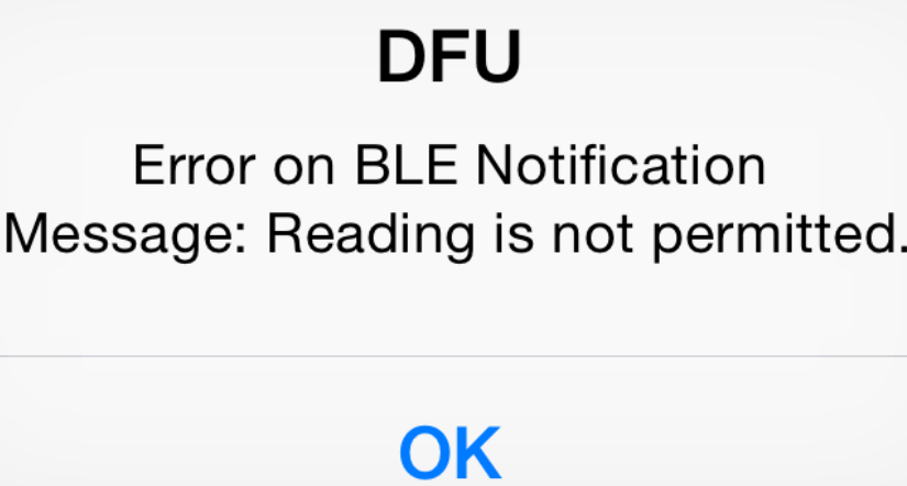

  1. I receive message like this.
Enable Msg
In some cases, this message also appears.
Msg 2
This means that I have to change the firmware as
#define IS_SRVC_CHANGED_CHARACT_PRESENT      0
to
#define IS_SRVC_CHANGED_CHARACT_PRESENT      1
this?

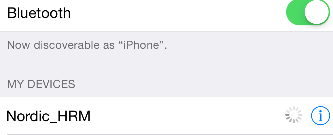

Surprisingly, regardless of the definition of IS_SRVC_CHANGED_CHARACT_PRESENT,
my Nexus 5 doesn't have any problems while updating the firmware.
  1. Is this another symptom if the iOS devices which did not reset the Bluetooth settings?
heart rate
After updating a HRS example to the board, my iOS device doesn't receive any data
; heart rate, location, or the battery level. The connection kept goes on but nothing appears.
Whereas the Nexus 5 receives the data correctly.
  1. Have I done reset the "Bluetooth Settings" of the iOS devices correctly?
reset
Or do I just have to erase this device?
settings
settings2
  1. Considering that, if I'm trying to sell a device that performs DFU, it could be
ridiculous to tell customers to reset their iOS devices' Bluetooth setting.
Is this a problem that iOS has to solve?
