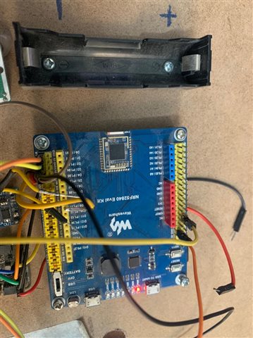

  • Hello Amanda,
    sorry for being late i am getting error using the file in the link please tell me where the issue is
    D:\nrf mesh>nrfutilmesh --verbose dfu serial -pkg dfu_test.zip -p COM7 -b 115200 -fc --mesh
    Upgrading target on COM7 with DFU package D:\nrf mesh\dfu_test.zip. Flow control is enabled.
    Flushing com-port...
    Opened com-port
    Starting DFU upgrade of type 4, SoftDevice size: 0, bootloader size: 0, application size: 130832
    Sending DFU start packet, afterwards we wait for the flash on target to be initialized before continuing.
    1: PC -> target: 0502aabbccdd
    2: PC -> target: 0502aabbccdd
    3: PC -> target: 0502aabbccdd
    4: PC -> target: 0502aabbccdd
    5: PC -> target: 0502aabbccdd
    6: PC -> target: 0502aabbccdd
    7: PC -> target: 0502aabbccdd
    8: PC -> target: 0502aabbccdd
    9: PC -> target: 0502aabbccdd
    10: PC -> target: 0502aabbccdd
    Failed to upgrade target. Error is: Failed to establish connection

  • Hello
    I want to clear one thing i have successfully done DFU with development kit but i want to do this with nrf52840 eval kit waveshare but when i try to do on that its giving me same error which i have showed you . Can you please tell me steps to follow to do DFU on waveshare eval kit of NRF52840 . I am attaching some pictures to show you my board . And tell me one more thing when we are trying to do on eval board so we have to program from jlink or USB board .
