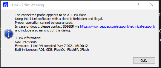

    Is there any issue if this warning comes after connection .
    It detects that your probe is a J-Link clone, and cannot guarantee the operation correctly. Please contact your provider for the issue.
