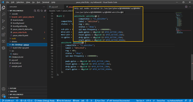

Only spi nodes accepted in /soc/peripheral@50000000/spi@b000/. /soc/peripheral@50000000/spi@b000/ads129xr@0/
Hi Nordic,
I am using nrf Connected SDK 1.7 on windows 10, coding with nrf connect extension for vscode.
I created a custom board from nrf5340 SoC and added a node as a device on SPI bus in custom board dts file, a error pops up when I put mouse pointer on the node name. it said "Only spi nodes accepted in /soc/peripheral@50000000/spi@b000/. /soc/peripheral@50000000/spi@b000/ads129xr@0/"
The error shows as in the picture yellow box below.
the project can build without any error.
the device tree fragment as below:
&spi2 {
	status = "okay";
	sck-pin = < 12 >;
	miso-pin = < 14 >;
	mosi-pin = < 18 >;
	cs-gpios = < &gpio0 15 GPIO_ACTIVE_LOW >;
	ads129xr0: ads129xr@0 {
		compatible = "ti,ads129xr";
		label = "ADS129xR";
		reg = <0>;
		status = "okay";
		spi-max-frequency = <4000000>;
		pwdn-gpios = <&gpio0 10 GPIO_ACTIVE_LOW>;
		reset-gpios = <&gpio0 11 GPIO_ACTIVE_LOW>;
		drdy-gpios = <&gpio0 13 GPIO_ACTIVE_LOW>;
		start-gpios = <&gpio0 17 GPIO_ACTIVE_HIGH>;

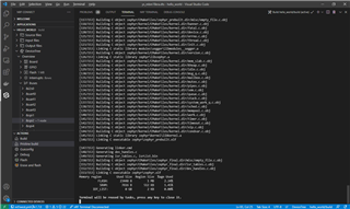

  • Hi wan,
    Could you share the screenshot of the build output?
    Swathy
  • Build output screenshot:
    build output log:

               FLASH:       23448 B         1 MB      2.24%
                SRAM:        7616 B       512 KB      1.45%
            IDT_LIST:          0 GB         2 KB      0.00%
    Terminal will be reused by tasks, press any key to close it.
  • finally this problem gone if close and reopen vscode.
