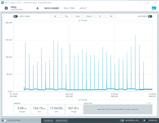

9160 System crash after CONFIG_DEVICE_POWER_MANAGEMENT is enabled
We have developed a project for the customer. In order to obtain longer battery life, we need to save power consumption, so we turn on CONFIG_DEVICE_POWER_MANAGEMENT. In order not to affect other places that need Uart, we will wake up Uart regularly according to TAU time.  But after 14 hours (our local TAU time is 30 minutes), the system crashes. Why?
Here are the sleep and wake operations I performed on the UART. Is there anything wrong with that?
    Do you have a fault log or similar showing the issue?
    Håkon
  • I can't see any useful information in logs, and based on my experience with previous tests, it looks like some application is using the uart while it's dormant.
  • Can you please share the log?
    Håkon
  • OK,I'll share this Log with you along with a screenshot of the power curve that PPK captured.
