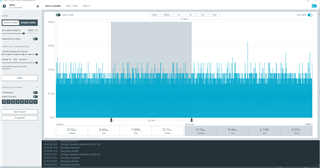

There is the consumption mesure by PPK2:
It's seem that between two advertisings the consumption is due to the enable uart.
I need to have the lowest consumption when the nrf5340dk is advertising.

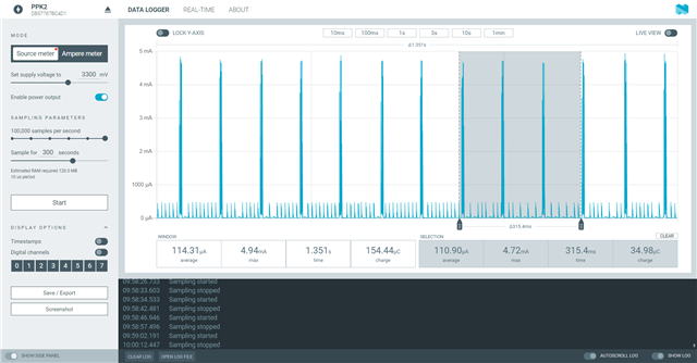

  • Good Morning Kazi,
    Thank very much you for your answer and your help.
    I'm not sure to understand your reply, I tryed to coment  "#CONFIG_SERIAL=y" and  "#CONFIG_SERIAL=n" into prj.conf, so I have no config_serial.
    After that advertising restart and I have a wonder consumption during advertising, arround 110uA !

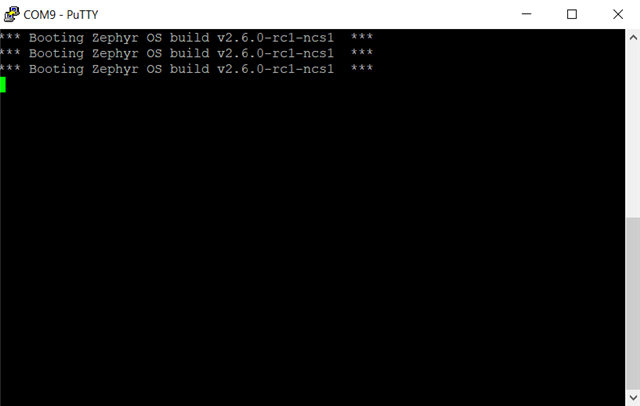

    But I can not use the uart when I'm connected, I tryed to send "azerty" from Rx Characteristic nothing was received by putty, after the third try it make my an error 133 Gatt Error and error 8 Gatt Conn Timeout.

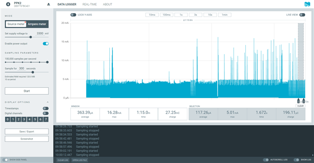

    When I made a reset, the consumtion start to be around 770uA and after connect and disconnect it fall around 117uA.
    It look like the uart do not wake up after connected. I think I forgot something to wake up the uart when I'm connected. And I should maybe put the function uart_0_disable() into uart_init() to start at a low consumption after reset.
