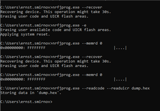

  • Hello Elfving!
    Thank you for the answer!
    Yes, I tried according instruction you attached, but seems that it didn't help :(
    I've attached the screenshot and the dump file.
    6332.dump.hex
    Many thanks for your concern!
    Have a great day!
    Best Regards,
    Ernst

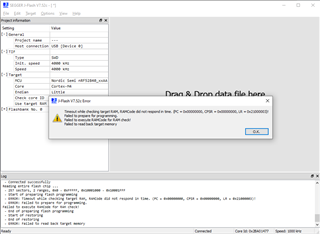

  • Hi!
    Yes, sure
    Take a look
    Hmmm, now it seems that I can flash it (I'm able to start a Keil debug session) , however during read out the flash data I get the next error:
