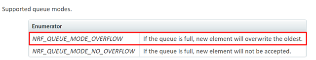

I use the function nrf_queue_write for queueing data. Also I use the NRF_QUEUE_MODE_OVERFLOW  mode to overwrite old data in case the queue is full.
My problem is that nrf_queue_write asserts when the buffer size is greater thant the queue size (see nrf_queue.c)

    I think this assert makes sense. Even if you use NRF_QUEUE_MODE_OVERFLOW attempting to queue more elements than there is room for in the buffer seems like an indication of a bug in the caller code.
    So what is the purpose of NRF_QUEUE_MODE_OVERFLOW? The documentation says that old data will be overwritten in case of overflow. Trying to queue more elements than the queue size doesn't lead to overflow condition?
