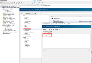

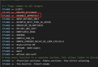

2. Program code compiled with MDK 8.40.1 or later, with ENABLE_APPROTECT defined.
I am using armgcc and segger? Can I do it like this picture below?
I search all the project but I can't find ENABLE_APPROTECT,why?

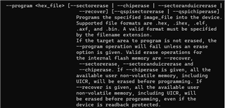

  • Why can't the program be run using the following command
    nrfjprog.exe -f NRF52 --recover
    nrfjprog.exe -f NRF52 --program xxx.hex
    nrfjprog.exe -f NRF52 --reset
    Need to use the following instructions to burn to run
    nrfjprog.exe -f NRF52 --eraseall
    Can I use nrfjprog.exe --eraseall?
    Yes.
    It's in the system_nrf52_approtect.h under nRF5_SDK_17.1.0_ddde560\modules\nrfx\mdk
    Because APPROTECT has been enabled. You need the --recover when APPROTECT has been enabled, which means you will need it after power cycling / pin resetting a device with empty flash.

  • Hi
    Thanks for your quick response,but I can't find system_nrf52_approtect.h.
    But I have to use the following two commands.
    nRF52832 rev3 is added in SDK 17.1.0 which contains system_nrf52_approtect.h.
    You can bundle --program with --recover.
    Can you try this ?
    nrfjprog.exe -f NRF52 --program xxx.hex --recover
    This approach ensures that the FW is written directly after the CTRLAP->ERASEALL (--recover), which makes it so that the intermediate unlocking image is not needed.
    The intermedia unlocking image must be removed when programming your fw image, hence a sector erase or page erase could in fact be used instead of eraseall if not bundling the commands after each other as proposed above.
