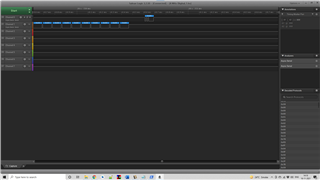

I am trying to implement mesh DFU, but the DFU is stuck at the 35th segment. When I probed the serial port I found out that the target is not sending ack.

I have successfully implemented DFU sometime ago, but now it is not working properly.
I have tried reinstalling python2.7, nrfutil and also used fresh SDK's. Still no success.
Image of serial port last packet. The last acknowledgement from the target is incomplete or incorrect.
Please suggest an appropriate solution for this.

  • Hi Elfving,
    The issue is resolved.
    The serial link was causing this issue.
    I double-checked my serial connections and tried with 2 development kits, but stuck with the same problem. However, it worked perfectly with the COM port of the DK.
    Don't know why this happened?
    Thanks for your support.
    Himanshu
  • Hi Himanshu!
    I am so glad it got resolved! I'm a little uncertain about in what way serial connections made this happen though. Which connection are you referring to?
    Elfving
  • Hi Elfving,
    I used a USB to Serial module to send DFU from PC to serial DFU node.
    I have used the same module some time ago and it worked perfectly fine, don't know why it didn't work this time however it is working with nRF52832.
    Himanshu
