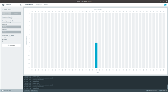

DTM (via nRF Connect) using a custom board
How is it possible to run a DTM Test on a custom board using the nRF Connect Tool?
I am able to run it successfully with 2 DK boards, but I need to run it on my custom PCB (fitted with an nRF52840).

  • I was able to compile it using an older SDK (15.3) and it works with the latest DTM Tool and a DK board.
  • How ever I need to run it on my own HW. Either through a SEGGER J-Link or UART (FTDI).

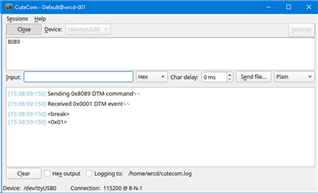

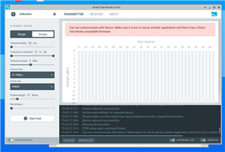

    I tried already to use the 2-wire UART. It is connect to the PC via an FTDI-usb-cable. The nRF Connect for desktop "Direct test mode" PC application does see it, how ever I always get the "Can not communicate with the device" error when I try to start the test.
    Is the dtm firmware example (https://github.com/NordicSemiconductor/pc-nrfconnect-dtm/tree/master/firmware/src ) able to work with 2-wire UART? I confirmed that the RX/TX lines are mapped correctly, also I disabled the HW Flow Control (CtS/RTS) lines:

    Which GPIOs are you using? Note that some GPIOs are not available by default, like the NFC pins (P0.09 and P0.10).

  • Yes, we use exactly those pins Disappointed:
    #define RX_PIN_NUMBER  9
    #define TX_PIN_NUMBER  10
    How ever it confuses me a bit as I tested the UART communication with an UART terminal and it worked correctly!
    Also the ublox datasheet notes that those pins can be used as long as we stay under 10 kHz!
    And we successfully use them for zephyr logging with 115200 baud!
    I also run into this feature from time to time.
    If you set the preprocessor define "CONFIG_NFCT_PINS_AS_GPIOS" and recompile your project, you should be able to use those pins as normal GPIOs.
    If you are using the nRF52840-DK with the NFC pins, you also need to add some zero ohm resistors on the kit itself.
