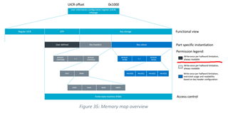

The following is a description of the KMU register.
https://infocenter.nordicsemi.com/topic/ps_nrf9160/uicr.html#register.KEYSLOT.CONFIG.PERM
infocenter.nordicsemi.com/.../kmu.html
The diagram here describes that OTP is always readable, and most of the content describes how to use key storage.
I accessed the KMU register in the application(ns) and found no effect. Do KMU registers need to be accessed in spm?
How can I obtain permission to read the OTP register. Are there any related demos?
