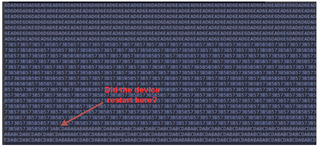

Uart corrupted when scanning with many advertisers in range
There seems to be a bug with scanning for many Bluetooth advertisements while simultaneously sending  data over uart in Nrf sdk v17.
I have tried to work around this issue by using the nrfx_uart/uarte library, and slowing the scanning rate. Both of these changes did not fix the issue, just made it take longer to show up. Also originally I was using nrf sdk v16, upgrading to v17 made the issue better but still shows up.
At the bottom of this post is a reproducible project that shows this bug.
If the code is programmed and the python script is pointing to the com port of the device, you will see that thereis a wild inconsistency with the data recieved.
If lines 166 and 167 are commented out (the nrf_ble_scan_start) and start the script again, the script will show that every 100 bytes received are in the same pattern
Note: this only seems to happen when there are a lot of advertisers around.
Can you please help find a solution to this problem?

  • Bug is here:
    static void send_uart_payload() {
    	uint8_t pl[30] = { 0 };
    	nrfx_uart_tx(&uart, pl, 30);
    The "pl" resides on the stack, and I am pretty sure nrf_uart_tx() is non-blocking. That allows other calls - like later advertisements - to overwrite the stack memory location of pl variable during UART transmission.
    First order fix is quite simple:
    	static uint8_t pl[30] = { 0 }; /* <-- static here */
    But in the long run you may need to switch to some kind of FIFO or a blocking UART function.
  • this did not seem to fix the problem. I have also created a zephyr project to confirm it was not  an implementation issue but it still happens. Also it is not required that any Bluetooth activity to be happening for this bug to happen, it just makes it more likely.
    You can reproduce the issue with this zephyr project:

  • Thanks for the code. I will try to let it run overnight to see if I get the same problem here. How long time does it take for you to reproduce the problem with this new code?
  • between 10 - 30 minutes. It is reproducible on nrf52 dk, DVK-NINA-B3 and custom hardware using a FTDI chip.
    Here is a python script that will assert when the problem is found.

  • Could it be an issue with the PC setup (USB hub,etc) or maybe an issue with PySerial? I used the RealTerm terminal here and stored all received data to a text file, then grepped through it to see if there were any corrupted data. Here's a dropbox link to the file if you are interested: https://www.dropbox.com/s/8nde44huwpa5ixw/uart_test.txt?dl=0
    Edit: Forgot to add that I ran the code on a 52 DK and used the on-board J-link as the serial bridge. Also, I left it running for about 4-5 hours.
  • I have tried with both SerialPortStream (C#) and pyserial and could replicate it with both libraries. Have tried it on a windows machine and linux machine with diffrent devboards plugged in, and have also done it on an upboard with a custom hat with 52s on it.
    I am going to try and create a project that just sends data between two devboards to eliminate it being anything to do with the computer.
