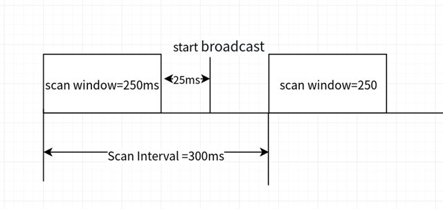

    I think of a peripheral and central device as one device, broadcast interval 300ms;The scan window is 250ms and the scan interval is 300ms。
    I want to broadcast in the scan idle 50ms, that is, after the scan idle start 25ms this point in time broadcast, this time I need to scan after the start of a 25ms timer, when the timer time is up, turn on the broadcast。So I want to know the end of the scan。
    Do you plan on having any other roles at the same time? like a connection? or is this the only scenario where you need to predict roles? It this is the only scenario you could use radio notifications on the inactive event to start a timer that lets you start advertising in the 50ms window. Please remember the advertiser has a 0-10ms random number so it's not possible to time it to exactly 25ms. due to this random number you will have to only advertise once, if you try to have a advertisement interval of 300ms the advertisements could drift and conflict with the scan window.
    One option if you need to have the advertiser at that exact option, is to use the timeslot api and implement your own advertisement routine at this exact place. But keep in mind you might violate the bluetooth core spec if you do not have the random delay for the advertisement.

    I wonder if broadcasts and scans are scheduled by the protocol stack on devices that are integrated with peripherals and central devices to ensure that they do not conflict, and that users only need to set the corresponding time parameters (e.g. broadcast intervals, scan window times, and scan intervals)? At the same time as peripherals and central devices as one of the devices, through radio event interruption inactive and inactive events is difficult to predict is the beginning and end of the broadcast, the beginning and end of the scan?
  • The central role connection and the scanner is scheduled to avoid conflict if you use the right parameters. But the peripheral role is set up by the peer device and could be in conflict with one of the other role. The SD will then prioritize according to the table: SoftDevice timing-activities and priorities And yes broadcast is also hard to predict as it has the random component as part of it's advertisement interval.
