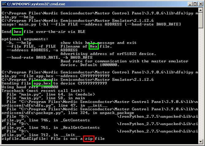

  • As far as I know, myproject.hex file is further not supported in MCP 3.9.0 because of init packet implementation (althoug feasible in GUI MCP). There is an omission in help.
    To make script working, myproject.zip must be generated with using nrf.exe instead.
    image description
  • I'm getting this same issue with the new masteremulator.dll, my python script worked fine before upgrading to latest dll. I'm not even using it to upload a hexfile, just scanning and reading some data from a characteristic. Is there any way I could get back the old masteremulator.dll?
  • I don't think the "[EXCEPTION] 'type' object has no attribute 'BTLE_CMD_LE_WRITE_SCAN_PARAMETERS" is related to *.zip or *.hex. I get the same error with both *.zip and *.hex when I use the old python DFU script with the new master emulator dll. I managed to delete the older revision of the masteremulator dll, I would really appreciate if you could provide it somehow. Or release a new compatible python dfu script (maybe its already out there, but I could only find similar code within the master control panel application, I haven't figured out how to extract the python code from there and make a simple standalone python script though...)
