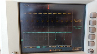

My question is: how is it possible to measure with an oscilloscope via GPIOs when the ADC that is triggered via PPI from PWM exactly starts and stops.
    As @hmolesworth mentions you may do this through connecting the SAMPLE and DONE/END event to the setting and clearing task of a GPIO through the PPI peripheral. You should then be able to see the exact time spent on the conversion on the oscilloscope scoping the GPIO. I am however not certain that I have understood why you would want / need the PWM peripheral in this mix - could you elaborate on this?
    Karl
    thanks for the input. Using your code I could see the ADC conversion as GPIO. It seems to be started correctly but needs a lot of time (>190 uS). I need the PWM to run a motor. And measuing the motor current should be synched with PWM.
    Great, I am happy to hear that you were able to see the SAADC timing using the PPI.
    Are you saying that a single conversion takes 190 µs? This would indeed indicate that something is wrong with the usage of the SAADC.

  • The PWM is responsible for the 190uSecs, nothing to do with the SAADC .. what are the PWM settings? I don't see them in the posts above
    how is it possible that the PWM blocks the ADC? Shouldn't the PWM only start the ADC? And then it is up to the ADC how long it will need. These are my PWM settings:
    The PWM will not be blocking the SAADC's execution - the SAADC will start a conversion as soon as the TASKS_SAMPLE task is triggered if it is not already busy. Which SAADC event are you now using to indicate that a single conversion has finished, and what buffer size for the SAADC are you using?
    It seems to me that the conversions itself take a lot shorter than 190 µs, if that is what is being indicated by the second channel going low in your oscilloscope picture.
