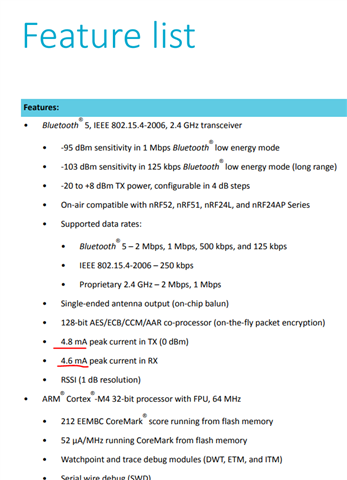

We are trying to know the current consumption during BLE RX & TX. However, there appears to be apparently conflicting information. Which is right?
In the product specification (nRF52840_PS_v1.6.pdf), it mentions 4.8mA TX (0dBm) and 4.6mA RX.

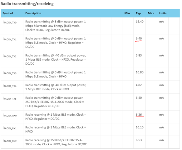

But in the Infocentre page (Radio transmitting/receiving section, Electrical specification, nRF52840 v1.6), it mentions IRADIO_TX1 = 6.40mA (0dBm, 1 Mbps BLE mode, Clock = HFXO, Regulator = DC/DC) and IRADIO_RX0 = 6.26mA (1 Mbps BLE mode, Clock = HFXO, Regulator = DC/DC). Indeed we could not find any figure here which is near the figures mentioned in the product specification.
Any idea what is going wrong? Thanks for your help.
