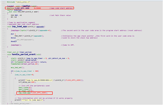

 bootloader:
typedef  void (*iapfun)(void);
#define FLASH_APP1_ADDR		0x3B000			//app code start address
iapfun jump2app;
__asm void MSR_MSP(uint32_t addr)
	MSR MSP, r0 							//set Main Stack value
	BX r14
//Jump to application segment
//appxaddr:app code start address
void iap_load_app(uint32_t appxaddr)
	jump2app=(iapfun)*(uint32_t*)(appxaddr+4);			//The second word in the user code area is the program start address (reset address)
	#if 1
		MSR_MSP(*(uint32_t*)appxaddr);					//Initialize the app stack pointer ,(the first word in the user code area is
	#else												//used to store the stack top address)
		__set_MSP(appxaddr);
	jump2app();									    	//jump to APP.
timer_out_st timer_period;
void handle_period_event(void)
	static uint32_t jump_to_app_timer = 0, pir_detect_ok_num = 0;
	static uint8_t dataW,dataR;
	if(!IsTimeOut(&timer_period)) return;
	TimeOutSet(&timer_period,10);
	mcu_led_set();
	if(++jump_to_app_timer > 300)
		jump_to_app_timer=0;
			printf("jump to app,0x3B000=%08x\n",*(uint32_t*)(FLASH_APP1_ADDR));
			nrf_delay_ms(100);
			// Turn off the peripherals used
			uart_close(0);
			uart_close(1);
			sk_timer_set(0);
			iap_load_app(FLASH_APP1_ADDR);
		// This information will not be printed if it works properly
		printf("***err to jump app\n");

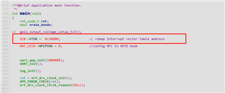

app:
SCB->VTOR =  0x3B000;				// remap interrupt vector table address
    Normally the SoftDevice assumes that the application is located immediately after the SoftDevice. It is possible to locate the application elsewhere though, but in that case you need to Configure the SoftDevice to forward interrupts properly (just jumping to the application like it seems you do is not enough). Please see this post for details. Note that interrupts must go via SoftDevice, so using VTOR will not work.

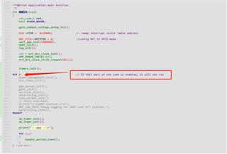

    app main code:
    	ret_code_t ret;
        bool erase_bonds;
    	gpio_output_voltage_setup_3v3();
    	NRF_UICR->NFCPINS = 0; 				//config NFC to GPIO mode
    	uart_app_init(1000000);
     	UART_Init();
        log_init();
    	ret = nrf_drv_clock_init();
    	APP_ERROR_CHECK(ret);
    	timers_init();
    #if 0 									// If this part of the code is enabled, it will not run
    	power_management_init();
    	ble_stack_init();
    	gap_params_init();
    	gatt_init();
    	services_init();
    	advertising_init();
    	conn_params_init();
    	// Start execution.
    	printf("\r\nUART started.\r\n");
    	advertising_start();
    	sk_timer_init();
    	sk_timer_set(1);
    	printf("---app --\n");
        for (;;)
    		handle_period_event();
  • can23 said:
    In the app code, after disabling the functions related to ble, jump from bootload to app, and it can work.
    But with the related functions enabled, it won't work anymore.
    What's the problem?
    In this part you enable the SoftDevice, and if you have not changed the way you start your application like I suggested (like not using VTOR) this will fail. You need to do as suggested in the post I linked to in my previous post when you use a SoftDevice.

    bootloader code:
    iapfun jump2app;
    	BX r14
    	#if 0
    /**@brief Function that sets the stack pointer and starts executing a particular address.
     * @param[in]  new_msp  The new value to set in the main stack pointer.
     * @param[in]  addr     The address to execute.
    void jump_to_addr(uint32_t new_msp, uint32_t addr)
        __set_MSP(new_msp);
        ((void (*)(void))addr)();
    // After 3 seconds, jump to app
    	static uint32_t jump_to_app_timer = 0;
    			nrf_delay_ms(100);
    			uart_close(0);
    			uart_close(1);
    			sk_timer_set(0);
    			#if 1
    				// Disable and clear interrupts
    				const uint32_t current_isr_num = (__get_IPSR() & IPSR_ISR_Msk);
    				const uint32_t new_msp		   = *((uint32_t *)(FLASH_APP1_ADDR));					// The app's Stack Pointer is found as the first word of the vector table.
    				const uint32_t reset_handler   = *((uint32_t *)(FLASH_APP1_ADDR + sizeof(uint32_t))); // The app's Reset Handler is found as the second word of the vector table.
    				__set_CONTROL(0x00000000);   // Set CONTROL to its reset value 0.
    			    __set_PRIMASK(0x00000000);   // Set PRIMASK to its reset value 0.
    			    __set_BASEPRI(0x00000000);   // Set BASEPRI to its reset value 0.
    			    __set_FAULTMASK(0x00000000); // Set FAULTMASK to its reset value 0.
    			    NVIC->ICER[0]=0xFFFFFFFF;
    			    NVIC->ICPR[0]=0xFFFFFFFF;
    			    NVIC->ICER[1]=0xFFFFFFFF;
    			    NVIC->ICPR[1]=0xFFFFFFFF;
    ////				 ASSERT(current_isr_num == 0); // If this is triggered, the CPU is currently in an interrupt.
    			    // The CPU is in Thread mode (main context).
    			    jump_to_addr(new_msp, reset_handler); // Jump directly to the App's Reset Handler.
    			#else

    thanks!
  • The way you jump to your application looks fine, but before you do this you must configure interrupt forwarding in the SoftDevice. What you need to do here is essentially what is done by nrf_bootloader_app_start() in <SDK14.2>\components\libraries\bootloader\nrf_bootloader_app_start.c, so I suggest you download SDK 14.2 and look at that (just for reference, as this specific part is done differently in a way that does not fit your needs in SDK >= 15.0.0). Essentially you need to do exactly the same.
