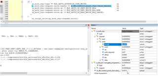

  • When I click on "Start DFU", the app goes to ble_dfu_buttonless_on_ble_evt, then to on_rw_authorize_req
    and there it does not reach the code in the "iffs". p_auth_req->type is empty... hm
    This is how it looks:
  • Ok. I don't know why, but it doesn't work from "BLE" app (NRF Connect suit), but it does when I use the nRF Tools on my mobile. New firmware is installed and boots up.
    Should I do something extra on the BLE app?
  • Do you use DFU with bonding by any chance, and if so, could it be that you bond when you test on the phone but not when you test with nRF Connect for desktop?
