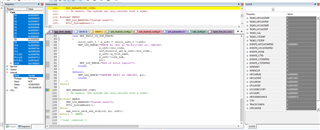

Dear Members,
I run 3 devices,
GPS on libuarte1
LCD on SPI2
Sdcard on SPI 1,
I'm using ANT and softdevice 340,
When I run LCD and SDcard outside the main loop, it's working ok,
by the time it's inside the main loop, it crashes with libuarte1,
Code :
									nrf_libuarte_async_config_t nrf_libuarte_async_config1 = {
            .tx_pin     = SER_APP_TX_PIN,
            .rx_pin     = SER_APP_RX_PIN,
            .baudrate   = NRF_UARTE_BAUDRATE_9600, //originally 28 Sept 2021
					  //.baudrate   = NRF_UARTE_BAUDRATE_38400,
            .parity     = NRF_UARTE_PARITY_EXCLUDED,
            .hwfc       = NRF_UARTE_HWFC_DISABLED,
            .timeout_us = 1000,
            .int_prio   = APP_IRQ_PRIORITY_LOW
		err_code=nrf_libuarte_async_init(&libuarte1, &nrf_libuarte_async_config1, uart_event_handler1, (void *)&libuarte1);
 /******************SDCARD  Sequence****************/
						NRF_SPI2->ENABLE = 0; //ILI9341 off
		          nrf_delay_ms(100);
			        NRF_SPI1->ENABLE = 1; //SDcard on
								fatfs_example();
								nrf_delay_ms(100);
            printf("\rRixtronix LAB GPS Query.... \r\n");
						 nrf_delay_ms(2000);
						GPSNeo_Process();
Debug :
nfo> app:
isting directory: /
   9550  RIXTRO.TXT<info> app: Writing to file RIXTRO.TXT...
nfo> app: 50 bytes written.
nfo> app: LOOP Rixtronix LAB.
rror> app: SOFTDEVICE: ASSERTION FAILED
nfo> app: Support us by subscribing,thanks...
nfo> app: Initializing disk 0 (SDC)...
nfo> app: Capacity: 30436 MB
nfo> app: Mounting volume...
<error> app: ERROR 0 [NRF_SUCCESS] at ..\..\..\..\..\..\..\..\components\librari
\libuarte\nrf_libuarte_async.c:230
 at: 0x0004877B
rror> app: End of error report
Any ideas on resolving it ? thanks

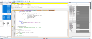

  • Hi Hung Bui,
    Thanks for the reply,
    I changed these lines
     ret = nrf_libuarte_async_tx(p_libuarte,p_evt->data.rxtx.p_data, p_evt->data.rxtx.length);
                if (ret == NRF_ERROR_BUSY)
                    buffer_t buf = {
                        .p_data = p_evt->data.rxtx.p_data,
                        .length = p_evt->data.rxtx.length,
                    ret = nrf_queue_push(&m_buf_queue, &buf);
                    APP_ERROR_CHECK(ret);
                else
    to :
      case NRF_LIBUARTE_ASYNC_EVT_RX_DATA:
                       GPS_CallBack();
    void	GPS_CallBack(void)
    	GPS.LastTime=nrf_systick_val_get(); //originally
    	if(GPS.rxIndex < sizeof(GPS.rxBuffer)-2)
    		GPS.rxBuffer[GPS.rxIndex] = GPS.rxTmp; //originally
    		GPS.rxIndex++;
    		memcpy((void *)line_buffer_GPS, GPS.rxBuffer, GPS.rxIndex);
       nrf_libuarte_async_rx_free(&libuarte1, (uint8_t *)&GPS.rxTmp, 1);
    The callback was working with different MCU,
    Any suggestions ?
    Thanks
  • Hi ,
    How many bytes do you receive when NRF_LIBUARTE_ASYNC_EVT_RX_DATA occurs ? You need to check the p_evt->data.rxtx.length to know the number of byte you received. I assume it's more than 1 byte   ?
    I can see you still calling nrf_libuarte_async_rx_free(&libuarte1, (uint8_t *)&GPS.rxTmp, 1); with just one byte in length.
    Please try to get to know how the libuarte works before using it.
