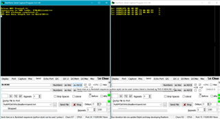

Hi everyone, I'm trying to communicate with OBDII through NUS using nRF52832. I was able to initiate the connection, send commands to OBDII, and get responses on the ECUsim 2000. However, I wasn't able to get the responses sent back to nRF52832 through bluetooth.

After I send commands from nRF32 to OBDII, I get the expected results on ECUsim 2000. However, these results are not sent back to nRF32!
while debugging the code, I found that IF statement of the on_hvx function (ble_nus_c.c)  is never met (always treated as FALSE), and I'm not sure why is this happening.

    I'm receiving the following error "0xFFF0 Service is not found", but I'm still able to connect and send commands to OBDII (but not able to receive results back).

    I tried to test the code with another nRF device with 128-bit UUID and it's working. Then I changed the UUID type of the peripheral to 16-bit, and updated the UUID type in the central code, it worked as well.
    However, for the OBDII it keeps saying that 0xFFF0 Service UUID not found.
    it's still not clear for me why I'm getting this error. I will summarise the issue down hopefully you or others can guide me through how to overcome it.
