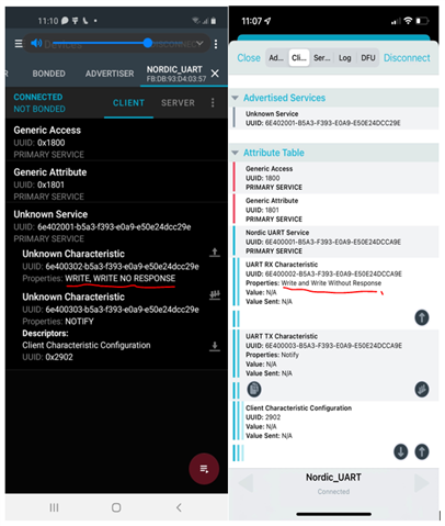

    The other sensor still will not respond at all to the Write command?  I will see if I can get its operating code because I suspect that if the values of the Write Characteristic command are not acceptable, so it immediately disconnects.
    Are you sure this characteristic includes the write property and not just write without response? Note that you can check what propertise the characteristic has through the nRF connect app.
    Screenshot of GATT server viewed in the nRF connect app. The left one is from an Android phone, and the one to the right is from an iPhone.
    Vidar
