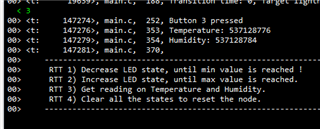

I am using sht85 to detect temperature/humidity in my Light lightness server code
 In the original server code, by pressing 1 or 2 you get to either decrease or increase the lightness level respectively. I modified the code so that when number 3 is pressed, both temperature and humidity will be display in the J-Link
This is the code for button number 3
 if(button_number == 3)
              int32_t temperature, humidity;
               int32_t temp_read, hum_read;
                  char temp_str[5];
                  char hum_str[5];
           int8_t ret = sht3x_measure_blocking_read(SHT3X_I2C_ADDR_DFLT,
                                                 &temperature, &humidity);
               if (ret == STATUS_OK) {
                temp_read = temperature / 1000;
                hum_read = humidity / 1000;
                itoa(temp_read, temp_str,10);
                 itoa(hum_read, hum_str, 10);
          __LOG(LOG_SRC_APP, LOG_LEVEL_INFO, "Temperature: %d\n", temp_str);
         __LOG(LOG_SRC_APP, LOG_LEVEL_INFO, "Humidity: %d\n", hum_str);

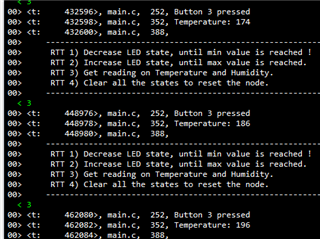

However, The display in J-Link is not what I had expected
The temperature and Humidity values are extremely high. Is there something I am doing wrong in the code? If so, please advise on what to change. Thank you!

    Thank you for your prompt reply ! I did the changes that you told me to do. However, the temperature values that appear in the J-Link appear to be just 0 even after pressing button 3 a few times.
    As such, instead of putting 'temperature' in the LOG, i tried it with 'temp_read' instead. Here is the code.
                      char temp_str[5];
                      char hum_str[5];
                  int8_t ret = sht3x_read(SHT3X_I2C_ADDR_DFLT,
                     temp_read = temperature / 1000 ;
                    //hum_read = humidity / 1000;  I removed humidity for this test first
                    // itoa(temp_read, temp_str,10);
                    // itoa(hum_read, hum_str, 10);
                  __LOG(LOG_SRC_APP, LOG_LEVEL_INFO, "Temperature: %d\n", temp_read);
    Ultimately, I managed to get something in the output. However I realized that the output is always goes in one loop from 0-255. Every time I press button 3, the temperature seems to increase until 255 before going back to 0 and starting all over again as shown in the picture here
    Any possible solutions to this? Your help is much appreciated
    Please try again with the blocking read (sht3x_measure_blocking_read) and check if it returns with an error.
    e.g.
                      char temp_str[5];
                      char hum_str[5];
                    // itoa(temp_read, temp_str,10); // Reduntant. The __LOG macro will do the conversion
                   __LOG(LOG_SRC_APP, LOG_LEVEL_INFO, "Temperature: %d\n", temperature);
                   __LOG(LOG_SRC_APP, LOG_LEVEL_INFO, "Humidity: %d\n", humidity);
                  } else {
                       __LOG(LOG_SRC_APP, LOG_LEVEL_INFO, "sht3x_measure_blocking_read() failed. Error: %d\n", ret);
