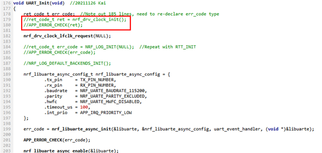

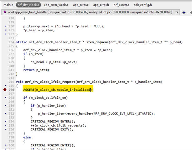

I have a question that i remark this code run different mode have different results
in Release  mode => build success,the project can run
in Debug mode => the debug terminal show : <error> app: ASSERTION FAILED at C:\Users\kai\Desktop\Git\BLE_nRF52832_1710\integration\nrfx\legacy\nrf_drv_clock.c:246
Attachment is my program, please help me to debug
