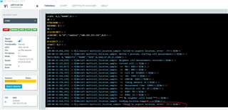

case about example multicell_location :multicell_location_sample: Failed to acquire location, error: -77
I get the log:
[00:00:30.320,159]
[1;31m<err> multicell_location_sample: Failed to acquire location, error: -77

4.test log:
