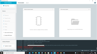

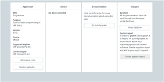

I am using Win10, nRF Connect 3.9.0, programmer 2.0.0. and I get "no matching trait found" when trying to program the 9160 on my board. I have seen a few other questions regarding this and wanted to confirm that the problem exist not only for Thingy91, but also for a custom board.
/Peter

  • Also, can you please run the following command in your command prompt: nrfjprog --version

    `nrfjprog --version` returns:
    nrfjprog version: 10.12.1
    JLinkARM.dll version: 6.88a
    Using a J-Link device for programming.
    The issue does not occur when trying to flash the modem fw on my nRF9160DK (Rev. 1.0.0) using the board's debugger.
    Update: Current workaround I found: It works when using the debug out port of the DK to programm our PCBs. So it seems to be an issue related to the nRF Programmer and J-Link adapter.
  • Hello, and thanks for sharing.
    There are known issues with latest version of the nRF Connect for Desktop 3.9.x and its internal apps, and using an external J-Link device to program, which we are working to solve.
    Currently, the best solution is to use nrfjprog command line to program your device with latest nRF Command line tools, which now supports modem updates. Or downgrade nRF Connect for Desktop to v3.7.1 with these steps:
