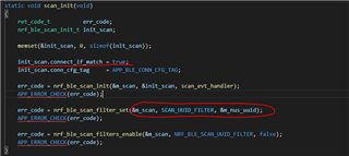

    I have uploaded the above-mentioed example codes but peripheral (ble_app_uart) is advertising and central(ble_app_uart_c  ) is not scannig and connecting.
    How can I add in central to connect with specfic device(By name search).
    Thanks
  • This is exactly what is done by the ble_app_uart_c example. It checks the name of the peripheral in the scan report and if it matches "Nordic_Blinky" it sends a connection request. Try flashing the peripheral with the unmodified ble_app_uart example and see if it connects.
  • hi @Jared
    I have uploaded the mentioned project but it's not scanning and I am also unable to see how central is scanning by name in the main code.

    /**@brief Function for initializing the scanning and setting the filters.
    static void scan_init(void)
        ret_code_t          err_code;
        nrf_ble_scan_init_t init_scan;
        memset(&init_scan, 0, sizeof(init_scan));
        init_scan.connect_if_match = true;
        init_scan.conn_cfg_tag     = APP_BLE_CONN_CFG_TAG;
        err_code = nrf_ble_scan_init(&m_scan, &init_scan, scan_evt_handler);
        err_code = nrf_ble_scan_filter_set(&m_scan, SCAN_UUID_FILTER, &m_nus_uuid);
        err_code = nrf_ble_scan_filters_enable(&m_scan, NRF_BLE_SCAN_UUID_FILTER, false);

    However I have checked ble_app_blinky_c which scans and connects with the given device name.. can I use this example code and send and receive data with the peripheral device?
  • Hi there!
    Sorry, I managed to mix the blinky example with the ble_app_uart_c example. The ble_app_uart_c does almost the same but it sets up a filter that checks the UUID of the advertising peripheral. If it matches with the filter then it connects:
    regards
    Jared
  • Hi there!
    regards
    Jared
