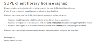

  • bluebeam said:
    If the NRF cloud can achieve the same thing then I don't necessary have to download the SUPL library. Am I right?
    Yes that is correct.
    bluebeam said:
    It only helps cold start TTFF, not GPS accuracy in general
    SUPEL or A-GPS does help with cold start but it is not the only area, it is bifacial regardless.
    We do recommend our A-GPS with nrfCloud solution.
