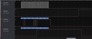

  • After looking through the logic analyzer and previous console outputs we have figured that the issue is occurring when we try using the NRFX_SPIM_XFER_TRX function.
    Our function is initialized as below:
    nrfx_spim_xfer_desc_t xfer_desc_data_buf = NRFX_SPIM_XFER_TRX( m_tx_buf,  cmdLen,
          m_rx_buf,  dataLen );
    Input:
    m_tx_buf = {0x03, 0x00, 0x00, 0x64} {CMD, 3 -byte addr}
    cmdLen = 4
    m_rx_buf[dataLen] = {0}
    dataLen = 5
    Output (Actual):
    m_rx_buf = {0x00, 0x00, 0x00, 0x00, 0xFF}
    Output (Expected):
    m_rx_buf = {0xFF, 0xFF, 0xFF, 0xFF, 0xFF}

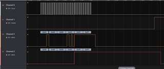

    Logic Analyzer:
    Input:
    dataLen = 6
    Output (Actual):
    m_rx_buf = {0x00, 0x00, 0x00, 0x00, 0xFF, 0xFF}
    Output (Expected):
    m_rx_buf = {0xFF, 0xFF, 0xFF, 0xFF, 0xFF, 0xFF}
    Logic Analyzer:
    Input:
    dataLen = 6
    Output (Actual):
    m_rx_buf = {0x00, 0x00, 0x00, 0x00, 0xFF, 0xFF, 0xFF}
    Output (Expected):
    m_rx_buf = {0xFF, 0xFF, 0xFF, 0xFF, 0xFF, 0xFF, 0xFF}
    Logic Analyzer:
    Conclusion:
    We believe that the TRX function is starting to read and fill the rx_buff even when the TX is still ongoing.
    The TRX function takes in the 4 bytes of the MOSI line (0x00) when the 4-byte cmd is still being pushed through and then the remaining (dataLen – cmdlen) are picked up from the MISO line.
    In the 3 above examples you can see that the Slave(MOSI) line is still remaining high even after the clock has stopped, this indicates the correct length and data being sent back.
    We think that the TRX function should only be filling the RX buffer after the TX cmd (cmdlen bytes) have been passed.
    Note: We have seen a similar issue when we try and read the device ID of the slave (20 bytes), this is only a 1 byte cmd and the correct data is stored in the rx_buffer because we read 21 bytes total, and ignore the first entry in the rx_buffer. This also highlights the same issue of (dataLen – cmdlen) bytes being read into the rx_buffer before the correct data is stored.
    This is as expected with the SPI protocol. There is a shift register on both sides that clocks data out as it receives data. Since the TX data buffer is one byte less than the RX buffer, the SPIM master has to clock out the ORC character, which seems to be 0xFF in your case.
    If the data from the slave is not ready yet when the data is clocked out on MISO, then you can just ignore the first bytes and expand the RX buffer so that you eventually receive the expected data.
    More on SPIM peripheral here.
    regards
    Jared
  • Hey jared,
    Thank you for the reply. Our coding is working now after ignoring the first byte ion the rx_buffer and reading the rest.
