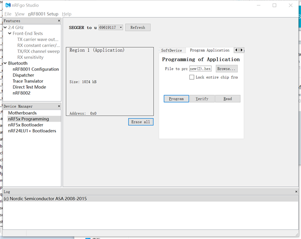

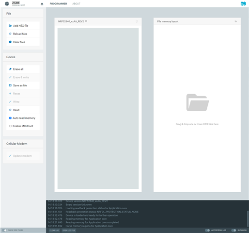

i have developed my device,and it was work in customs,but there is some device cant work after work some times.we  recall the device and discover the firmware was loseed by read the falsh of the device?
