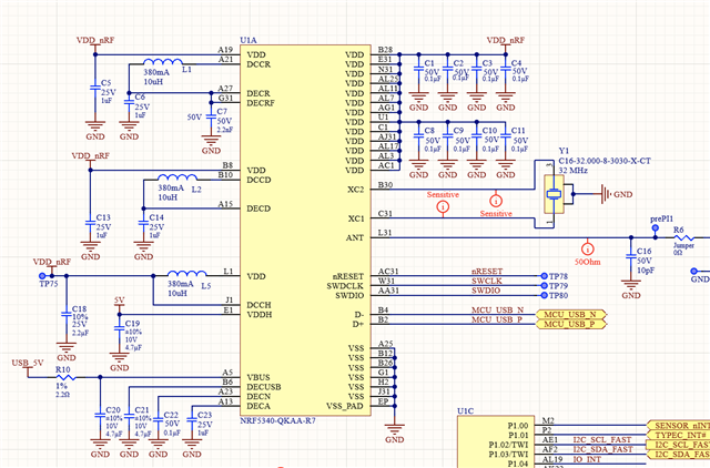

Hi all,
I'm in the process of bringing up a new board with an nRF5340 and am seeing some strange behavior. Via JLink SWD, I am able to connect to the application core on the nRF5340 as below:

However, if I attempt to flash, the process fails due to read back protection and, when I attempt to recover, that process fails. I've attached a log from the attempted recovery to this ticket as well.
The device is currently powered via VBUS/VDDH, as shown in the schematic screenshot below.
Any advice or suggestions on useful next debug steps would be much appreciated. Thanks!
