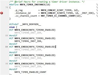

    Thanks for pointing that out. I did miss the nrfx_nfct.c file. Looks like the previous errors are gone but now I got a new one when compiling nrfx_nfct.c the error leads to nrfx_timer.h  I remember I saw somewhere in an NFC example which says that timer4 should be left for NFC and that is the case in sdk_config.h of the NFC examples where only NRFX_TIMER4_ENABLED is set to 1 and others timers are 0. Any idea how to fix this one?

    Another question about this error,  NRFX_TIMER1_INST_IDX is black and NRFX_TIMER4_INST_IDX is grayed out, does that mean the NRFX_CHECK() find NRFX_TIMER1_ENABLED = 1 and NRFX_TIMER4_ENABLED = 0 in the sdk_config.h? But what i have in the configuration is
    // <e> NRFX_TIMER_ENABLED - nrfx_timer - TIMER periperal driver
    #ifndef NRFX_TIMER_ENABLED
    #define NRFX_TIMER_ENABLED 1
    // <q> NRFX_TIMER0_ENABLED  - Enable TIMER0 instance
    #ifndef NRFX_TIMER0_ENABLED
    #define NRFX_TIMER0_ENABLED 0
    // <q> NRFX_TIMER1_ENABLED  - Enable TIMER1 instance
    #ifndef NRFX_TIMER1_ENABLED
    #define NRFX_TIMER1_ENABLED 0
    // <q> NRFX_TIMER2_ENABLED  - Enable TIMER2 instance
    #ifndef NRFX_TIMER2_ENABLED
    #define NRFX_TIMER2_ENABLED 0
    // <q> NRFX_TIMER3_ENABLED  - Enable TIMER3 instance
    #ifndef NRFX_TIMER3_ENABLED
    #define NRFX_TIMER3_ENABLED 0
    // <q> NRFX_TIMER4_ENABLED  - Enable TIMER4 instance
    #ifndef NRFX_TIMER4_ENABLED
    #define NRFX_TIMER4_ENABLED 1
    I solved the issue. In the sdk_config.h of nfc examples there are only nrfx_timer where nrfx_timer_enabled and nrfx_timer4_enabled are set. But the ble_uart example has both timer and nrfx_timer, so both timer4_enabled and nrfx_timer4_enabled should be set to get it work.
