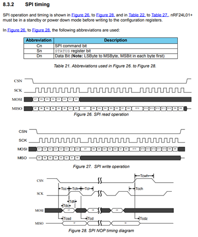

I am unable to read  the default values in the register map. The values I get are not similar to the ones in the datasheet.
I am assuming the SPI between the PIC18F4550 and the nRF24L0+ is working fine, as the Status register and the Config register default values (0x0E and 0x08) are correct.
Below is the C code used to read the nRF24L0+

This is the data received via the USB port
Register              Actual      Expected   Address
CONFIG              0x08        0x08           0x00    F0
EN_AA                 0x08       0x3F           0x01    F1
EN_RXADDR     0x3F       0x03           0x02    F2
SETUP_AW        0x3F       0x03           0x03    F3
SETUP_RETR   0x03       0x03           0x04    F4
RF_CH                0x03       0x02            0x05    F5
RF_SETUP         0x03      0x0F           0x06    F6
OBSERVE_TX    0x03      0x00           0x08    F7
CD                        0x03      0x00           0x09    F8
Rx_PW_P0         0x00       0x00            0x11    F9
FIFO_STATUS    0xC2       0x11            0x17    FA
DYNDP                0xC5      0x00           0x1C    FB
FEATURE            0xC5      0x00           0x1D    FC

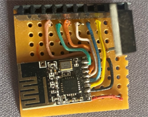

below are the break out boards I am using, I tried both the nRF24L0 and nRF24L0+. I get the same results
