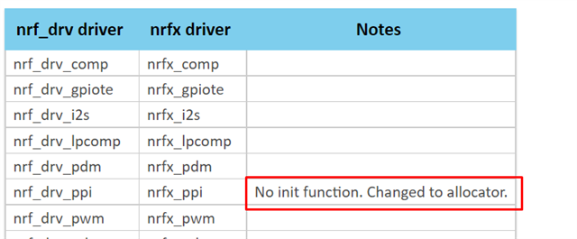

I use the nrf52840 and the SDK 16. I copied the saadc example and I want to modify it and use the RTC instead of the timer as an event for PPI. I've noticed that the example uses the legacy driver instead of the new nrfx implementation. I want to migrate into the nrfx driver. I found this migration guide but it's not clear to me. In the API reference of the PPI allocator there is no function for initialization. Should I use the legacy API nrf_drv_ppi_init()?

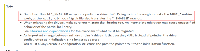

Also in the migration guide, there is the following note that I do not understand.
Also, according to the following note should I keep both PPI_ENABLED and NRFX_PPI_ENABLED set to 1?
// <e> NRFX_PPI_ENABLED - nrfx_ppi - PPI peripheral allocator

  • In the API reference of the PPI allocator there is no function for initialization. Should I use the legacy API nrf_drv_ppi_init()?
    No, there is no initialization/uninitialization functions in this API. You only need to allocate, assign, and enable a channel for it to work.
    Hmm, do you you currently have an issue with building the new PPI driver? I'd start by setting both to 1, and if that does not work, set PPI_ENABLED to 0.
    If I set both to 1 it compiles fine. If I set PPI_ENABLED to 0 it cannot find the nrfx based functions. So, I guess every time I use the new implementation (nrfx drivers) I have to enable the legacy as well?
    Yes, that's what I've experienced at least.
