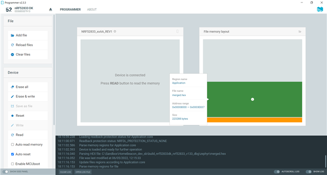

  • Good Morning Einar,
    We managed to solve the problem by just installing nRF Connect for Desktop on the new machine.
    Thank you for your support.

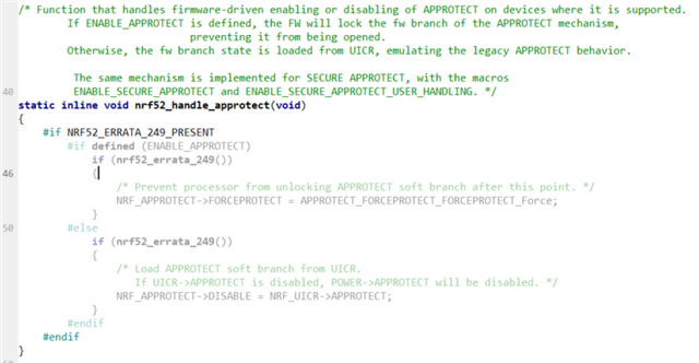

    Referring to nRF Connect SDK 1.9.1 you have modules/hal/nordic/nrfx/mdk/system_nrf52_approtect.h which handles APPROTECT. There you can see that the nrf52_configuration_249() is checked and this returns true for devices with the new APPROTECT mechanism and false for the older.
    I would like to avoid moving to v1.9.1 at this moment in time if I can help it.
    In SDK 1.7.0 I can only find in stystem_nrf52_approtect.h the function
    static inline void nrf52_handle_approtect(void)
    Is there something similar in v1.7.0 that will allow me to read the chip revision ?

  • Hi Mohamed,
    You have the same functionality in 1.7.0. There you have nrf52_errata_249() in modules\hal\nordic\nrfx\mdk\nrf52_erratas.h which is used from modules\hal\nordic\nrfx\mdk\system_nrf52_approtect.h. So also there, this is handled automatically by the MDK and you don't really need to do anything. But if you for some reason want to have your own code for handing this (like it seems you do in your system_SetDebugPortAccess(), though I don't really see the need thins the MDK  handles it for you), you can use this function to distinguish between old revisions with old APPROTECT (HW only based) mechanism and new APPROTECT mechanism (HW + SW based).
    Looking in system_nrf52_approtect.h I can see the code inside the function nrf52_handle_approtect() is disabled because NRF52_ERRATA_249_PRESENT is defined as 1 in nrf52_erratas.h.
    Do I need to define ENABLE_APPROTECT?
    Yet you said this is handled automatically in the MDK. I must be missing something.
    Also, it seems the the function nrf52_errate_249() always returns false unless NRF52_SERIES is defined.    How can I add the pre-processor directive -DNRF52_SERIES in Segger Embedded Studio v5.60?
    There are many macros and I am not sure which ones I need to define and which ones are handled automatically by the MDK. Please clarify.
