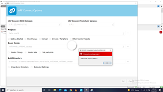

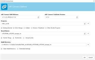

I installed nRF Connect Desktop. Opened Tool Manager. After sucessful installation, I tried to create ny first project by opening SES through nRF. The selections used are shown in attached image. There appears a warning... project not created...
Hi Gulzar,

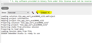

Could you click "OK" and then share a snippet of your output window?
This is a sample of the output window.

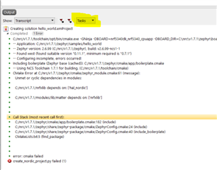

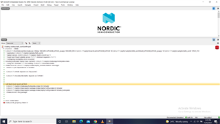

Dear.. after clicking the OK button on Dialog box... the output Window is in image. Cmake related error...
Dear PK, Here is the Task Output in image below. I am yetbtetsing "Hello World" sample project as I am new to Nordic.
Creating solution hello_world.emProject
C:/nrc/v1.7.1/toolchain/opt/bin/cmake.exe -GNinja -DBOARD=nrf5340dk_nrf5340_cpuapp -DBOARD_DIR=C:\nrc\v1.7.1\zephyr\boards\arm\nrf5340dk_nrf5340 -BC:\nrc\v1.7.1\zephyr\samples\hello_world\build_nrf5340dk_nrf5340_cpuapp -SC:\nrc\v1.7.1\zephyr\samples\hello_world -DNCS_TOOLCHAIN_VERSION=1.7.1 -DEXTRA_KCONFIG_TARGETS=menuconfig_ses -DEXTRA_KCONFIG_TARGET_COMMAND_FOR_menuconfig_ses=C:\nrc\v1.7.1\toolchain\segger_embedded_studio/html/configure_nordic_project_menuconfig.py
-- Application: C:/nrc/v1.7.1/zephyr/samples/hello_world
-- Zephyr version: 2.6.99 (C:/nrc/v1.7.1/zephyr), build: v2.6.99-ncs1-1
-- Found west (found suitable version "0.11.1", minimum required is "0.7.1")
Including boilerplate (Zephyr base (cached)): C:/nrc/v1.7.1/zephyr/cmake/app/boilerplate.cmake
-- Using NCS Toolchain 1.7.1 for building. (C:/nrc/v1.7.1/toolchain/cmake)
CMake Error at C:/nrc/v1.7.1/zephyr/cmake/zephyr_module.cmake:61 (message):
Unmet or cyclic dependencies in modules:
C:/nrc/v1.7.1/nrfxlib depends on: ['hal_nordic']
C:/nrc/v1.7.1/modules/lib/matter depends on: ['nrfxlib']
C:/nrc/v1.7.1/zephyr/cmake/app/boilerplate.cmake:182 (include)
C:/nrc/v1.7.1/zephyr/share/zephyr-package/cmake/ZephyrConfig.cmake:24 (include)
C:/nrc/v1.7.1/zephyr/share/zephyr-package/cmake/ZephyrConfig.cmake:40 (include_boilerplate)
CMakeLists.txt:5 (find_package)
error: cmake failed
create_nordic_project.py failed (1)

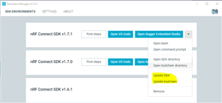

Could you try removing all the build folders from your hello_world sample and then could you try to update your SDK and Toolchain directory from the Toolchain manager as shown below?
After this, kindly try to build again, preferably by selecting "clean build directory".

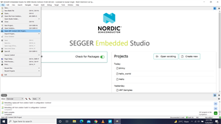

Hi PK, thanks for your guidance. The "Hello World" and "Blinky" samples have been successfully build. Now, I want to know: How to create a new Project uisng nRF Project. There is option to open existing nRF project.. pls see image but not option to create new nRF project in SES.
Gulzar Singh
For this, you could create a project and save it within your directory location (yours must be c:/nrc/v1.7.1) and then select the "open nrf Connect SDK Project..." and select your project in the "Projects:" section. This will be loaded into SEGGER just like any other project.
