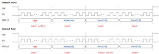

I am yoo at korea.
We will connect OLED with QSPI and Driver IC supports SLOWREAD.
- 8bit (Opcode: 0x03) + 24bit  (Addr) + 8bit (Read value: Mandatory) + 8bit (Read value: Optional) ... + 8bit (Read value: Optional)

  • Hey Yoo,
    I'm afraid the QSPI peripheral only supports the specified Instruction set. The QSPI is tailored for flash devices and is not a generic QSPI peripheral. I will ask my colleagues if we have any work-around for this issue. If we could get any information on the display and it's spec we could tell you definitely whether we can support it or not.
