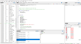

    Yes, I am getting the  NRF_BLE_SCAN_EVT_NOT_FOUND event, exactly.
    OK, can you log the addresses of the advertisment packets that are received when you get NRF_BLE_SCAN_EVT_NOT_FOUND and see if your device shows up or not?

    Yes, the address is shown. And the type is 0x2 that. as you said in the first place, is "private resolvable".
    So I guess I will need to find another strategy to filter the advertisement packets.
    Thank you

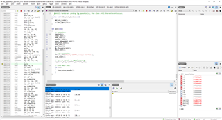

    Edit: The address type is actually set to public. They type is printed before the address, not after. I suggest you try to build my sample with a fresh copy of SDK 17.1.0 in case there is a chance the scanner module may have been modified in your current copy.
    I have run the code in the newest SDK version and it won´t work. I am even printing the address the filter is set to and it is correct; however, the same address and type appears in the not found list,
