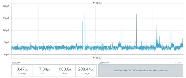

Hi, I am trying to measure power consumption (the device is an nRF52840 dongle) and I get different results when the board is connected or not to a JLink external debugger. The surprising result is that generally the current is _lower_ when the JLink is connected. My config is

When the Jtag interface is connected (and the debugger powered up/connected to USB) my "Idle" code (which is a k_sleep() with some gpios initialized for the leds and the button) gives me between 3-4 uA.

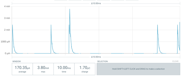

However, when I remove the jtag interface cable I get around 150uA while idle which then slowly goes down to 70-80uA. The mean value is obtained averaging over short spikes around 2mA
When I now start bluetooth advertising from this state, the current goes down(!) to 25-30uA (with the blue led on!).
I don't understand why this is happening, the JTag is interfering a lot in the power measurements, can anyone shed a light on this?
  • Hi, these results seem a bit strange to me. It's normal to get some leakage current on the SWD interface (nRF uses SWD not Jtag). Whether the current goes up or down depends on the voltage on the JLink. Usually the voltages should be matched using the VRef pin, but I've seen many times that this is not the case and the JLink will either source or sink current. So you should always unplug the debugger before any current measurements, then you don't have to worry about any leakage currents.

  • OK I see. Are you connecting the CR3032 to the VDD_nRF pin?
    The PPK in ampere meter mode should also have a ground reference to the dongle. So connect one of the GND pins on the PPK to the negative side of the battery. I believe this might be the reason for the weird behavior you are seeing. Because when you connect the JLink the ground reference is made through the USB interface to the PPK
  • You were right, thank you very much! The JLink provided the missing ground reference, now I get the same results with and without JLink, connecting the PPKII GND. I now get 50uA for idle and 500 uA for advertising. I think the idle value is still too high, but this is probably a problem in my code.The example you mention is an SDK example, is there anything similar available for nRF Connect?
