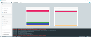

I have a problem with my nrf dongle i have working example on the DK and i could not put this onto the dongle. I tried dedicated examples and they are not working too. For example ble app blinky the softdevice and the app file were good, device had green light however when i tried to connect via my phone (nrf connect app) it could not connect and the dongle changed its light to red and was not able to detect by nrf connect on PC. Also i could not programm the bootloader (open_bootloader) from examples for PCA 10059. I do not know what to do next.
