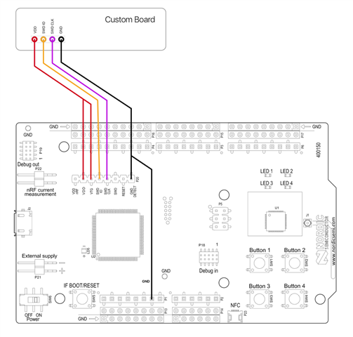

I'm trying to connect external nrf52832 module to nrf52-dk (PCA10040). I use wiring scheme from this picture:
And it works fine for programming. But I can't get RTT messages from my external module - only from onboard chip.

  • So, finally I figured out. As I said before I use PlatformIO as IDE and Zephyr as framework. For printing debug messages I used printk() function and wathced results in PlatformIO terminal. But I missed that terminal shows data as serial monitor and it get this data from uart link between nrf-chip and jlink-programmer chip. When I tried connect to J-Link RTT Viewer I've see nothing and this moment I suspect that my debug messages has transferred not through SWD but through uart.
    Problem was fixed after adding
    CONFIG_USE_SEGGER_RTT=y
    CONFIG_RTT_CONSOLE=y
    CONFIG_UART_CONSOLE=n
    in prj.conf
