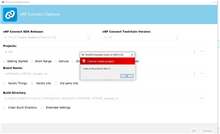

    i did changed the overlay file name but it doesn't work anymore
    it's not even opening
  • what can i do please to figure out this issue, i can no longer open my project
    can you help me please
