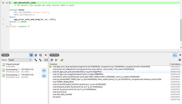

Error code generated with nrf_gpio.h after programming
SDK Version: SDK_17.1.0_ddd560
Chip: nrf52820
Board: PAN1781 Evaluation Board
IDE: Segger Embedded Studio for ARM v_5.62
Softdevice: S140
Windows 10
I'm currently attempting to test the ble_app_blinky_c program and have it connect to ble_app_blinky. I have reconfigured both programs as per this guide so the RAM and FLASH values matched with my board.
At this stage I have successfully downloaded ble_app_blinky and ble_app_blinky_c to two boards and both compile successfully. However when viewing the activity on the J-LINK RTT viewer it generates the following output (relevant params have been set to debug):
00> <info> app_timer: RTC: initialized.
00>
00> <error> app: ERROR 3735928559 [Unknown error code] at ../../../../../../modules/nrfx/hal/nrf_gpio.h:492

  • This check has failed in causing a manual assert
    __STATIC_INLINE NRF_GPIO_Type * nrf_gpio_pin_port_decode(uint32_t * p_pin)
        NRFX_ASSERT(nrf_gpio_pin_present_check(*p_pin));
    What pin number have you supplied here and what is your chip full version (laser markings)?
  • Hi there, thanks for the reply and apologies for only getting back today.
    The chip full version is ENW89857A1KF. I have checked for the value p_pin and it doesn't seem to have one (though i may not be able to find this purely due to my current knowledge of SES).
    I tried going to definition, which returned me to the same place in nrf_gpio.h. I also tried going to declaration with the same result. Finally I attached a watch and ran debug, but it still comes up as "p_pin symbol found". I have to assume it doesn't have a declared value anywhere in the code but I am willing to be wrong.

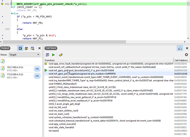

  • Hi Susheel I am getting the exact same error anytime I run my application in debug mode: <error> app: ERROR 3735928559 [Unknown error code] at C:/nRF5_SDK_17.1.0_ddde560/modules/nrfx/hal/nrf_gpio.h:492
    PC at: 0x00038B67
    <error> app: End of error report
    I never saw an actual resolution posted here so thought I would inquire as to what was changed that resolved the issue?

  • This is a custom application we are developing at my company for a customer, a custom consumer electronics application based on the NRF8240 in a laird module. We actually inherited this project that was started by someone else, I believe they used 1 of the BLE example applications as their starting point. I was able to develop for months in debug without issue, but over the past few weeks I can only use Release or else I run into this fault.
    This is one of the systems of stack overflow, What is the RAM usage of your application? have you benchmarked it? in anycase, this seems to be a bit different environment that you have compared to this case (even though the symptoms looks same) .
    I would suggest you to create a new thread and investigate it from there. Please give as many details as possible in case we need to replicate this at our desk. If I were you , I would first try to replicate this on our nRF52840 DK to exclude suspicions on the custom hardware.
