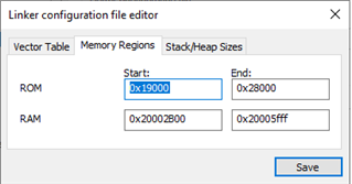

I am using s112_nrf52_7.2.0_softdevice with nRF5_SDK_17.1.0 and iar embedded workbench. I can flash and run the application without any problem but when i try to program secure_bootloader_ble_s112_pca10040e or secure_bootloader_ble_s112_pca10040e_debug I get harfault exception (A coprocessor access error has occurred (CFSR.NOCP) while i am using FLOAT_ABI_SOFT. Here is my linker configuration.

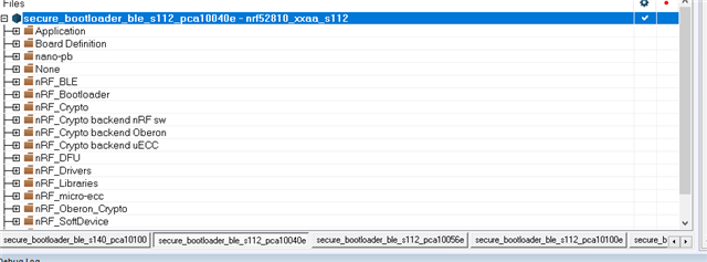

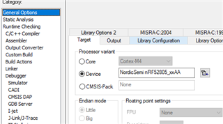

  • Did you select nRF52805 in the General Options?

  • I already have the latest MDK, and I used crypto libs with iar 8 before but with nrf52840 and I fixed these problems, and yes I set the nrf52805.

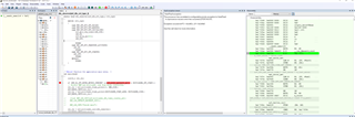

    The problem is i am not geting anywhere in the bootloader its not even coming to the main. when I program the bootloadrer and get the harfault , I flashed the application, but its geting the same hardfault as well, so i have to erase the chip and reprogram softdevice and the app again.

    I want to use NRF_BL_DFU_ENTER_METHOD_GPREGRET.
    This is the default behavior (NRF_BL_DFU_ENTER_METHOD_GPREGRET is set to 1 in sdk_config.h), you don't need to modify the source code for this(looks like you have done this looking at the screenshot you posted.)
    PS: You should remove DEVELOP_IN_NRF52832 and NRFX_COREDEP_DELAY_US_LOOP_CYCLES defines when testing on a nRF52805 device.
