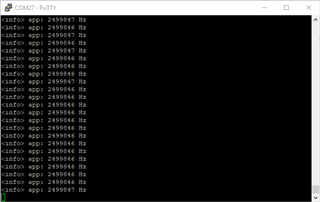

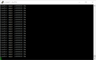

As long as the PWM frequency on the GPIO pin is below ~2.66 MHz, the measured value is correct, here some results for different frequencies (generated with a signal generator):
Input Frequency 1.5MHz:
Input Frequency 2.5MHz:
If i increase the frequency to 3 MHz, the measured value is incorrect:
According to this thread the nRF52 is not able to measure frequencies above 2.66 MHz. Is this true??

  • Hello hypn0,
    Sorry for the late reply. Without having checked or done the math, I believe this frequency is about the maximum frequency possible to measure using PPI.
    The PPI itself is running at 16MHz. There i up to 1 tick delay on the PPI, so that gives you a 8MHz. The you have some delay in the GPIO itself. The pad capacitance is 5pF. Depending on the input signal you are measuring it will take a certain amount of time from you set the output high until the input on the nRF is actually pulled high. If this takes a few µs, then that would explain the delay you are seeing.
    If you try to use a logic analyzer to measure your input signal, and then use the PPI to toggle a pin on every GPIO event (so that you basically duplicate the input signal), what sort of delay are you seeing between the (PWM) input and the (GPIO) output using the PWM generator that you are using?
    Edvin
