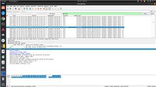

I am using ble_hrs_heart_rate_measurement_send API to send notifications to my central device which is a android mobile.
Recently I have observed packet loss at central device due to L2CAP packet length is differ from ACL packet length.
In the HCI_ACL packet, total length is 27. But in the ACL payload which is L2CAP packet length is showing as only 2. Total payload is present in L2CAP.
Hence my application running on mobile is unable to fetch the packet from L2CAP since it is dropped at HCI.
Attached is wireshark screen shot for reference. Highlighted packet was dropped at HCI.
Where could be the issue ? Any pointers would be really helpful.

  • Hi
    Is the payload length=2 you mention is from the following?
    If so, I think this indicates the length of the "Data Total Length":
    As highlighted in this image after I click the Data Total Length, the two bytes are 1b 00, where 0x1b = 27.
    I am not able to find what the error is from this trace though.

  • Hi Sigrud,
    Thanks for response.
    Sorry for sending wrong file. Please find attached log(10-12-diff7.log) and screen shot of the problem.
    Check the packet number 3479 from snoop log. Which has total ACL Packet length is 27 (1b 00) circled in BLUE.
    But in L2CAP payload, length of L2CAP packet is shown as 02 00 (which was highlighted in RED circle). But total length of packet is 27 which matches ACL length. How could this happen?
    Please compare this packet with other packets around it to see the difference.
    Because the length of L2CAP was not populated properly, it is not getting recognized as a L2CAP data packet at the central device. Hence the packet is lost.

  • Hi
    I looked some more into the trace you sent and when I were able to decode it, I find the L2PCAP length is indeed incorrect.
    This is likely due to the Bluetooth stack of the phone having decoded the length field incorrectly.
    In this case, we are not able to help you with the issue, as it is in with the Bluetooth stack of the phone, rather than an error with our device.
    To be certain that the nRF52 is sending the correct message, an on-air sniffer log would confirm how the messages look in transit, and which end is having the issue.
