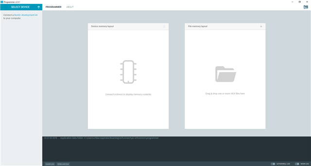

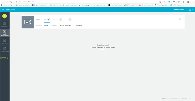

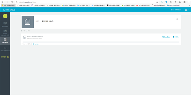

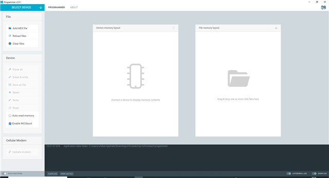

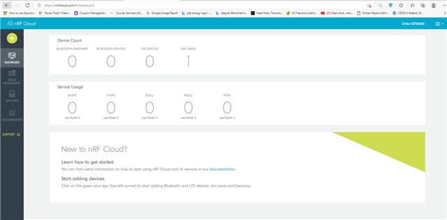

 @Nordic Semiconductor  General Chip nRF9160 rev2 Voltage 3.7 PSM Periodic TAU 5.0 hours Periodic TAU timer element "00011110" Active time timer element "00000000" RRC connected mode Data upload interval 4.0 hours Data upload charge 1.85 mC cDRX average current 5.87 mA cDRX charge 39.46 mC Connection management charge 24.81 mC Total charge 26.66 mC After using the power profiler link you sent to me, I had this result from the calculations. Does this result mean that it can handle 3 months data transmission with the current setting. Thanks for your help. I have also attached the screenshots on a new device that I have bought but the application wont detect it. I have installed everything including trying to update the firmware but the device wont be found. Is there anything am not doing right?
     Is the device showing in the device manager on your computer? Please verify that the USB cable that you are using supports data transmission.
    Have you gone through the nRF9160DK Getting started or the Thingy:91 Getting started?
